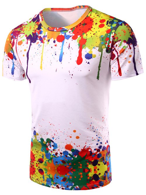

I've had a customer supply some poly shirts which are already printed using what looks like dye sub ink (image attached of something similar).
I need to be able to print these for a hen night - I don't have any spares so asking info on what others would do.
The print will probably be just text, so either vinyl or dye sub would suit - any ideas folks of best route and what will happen to the image already on the shirts if I used dye sub?

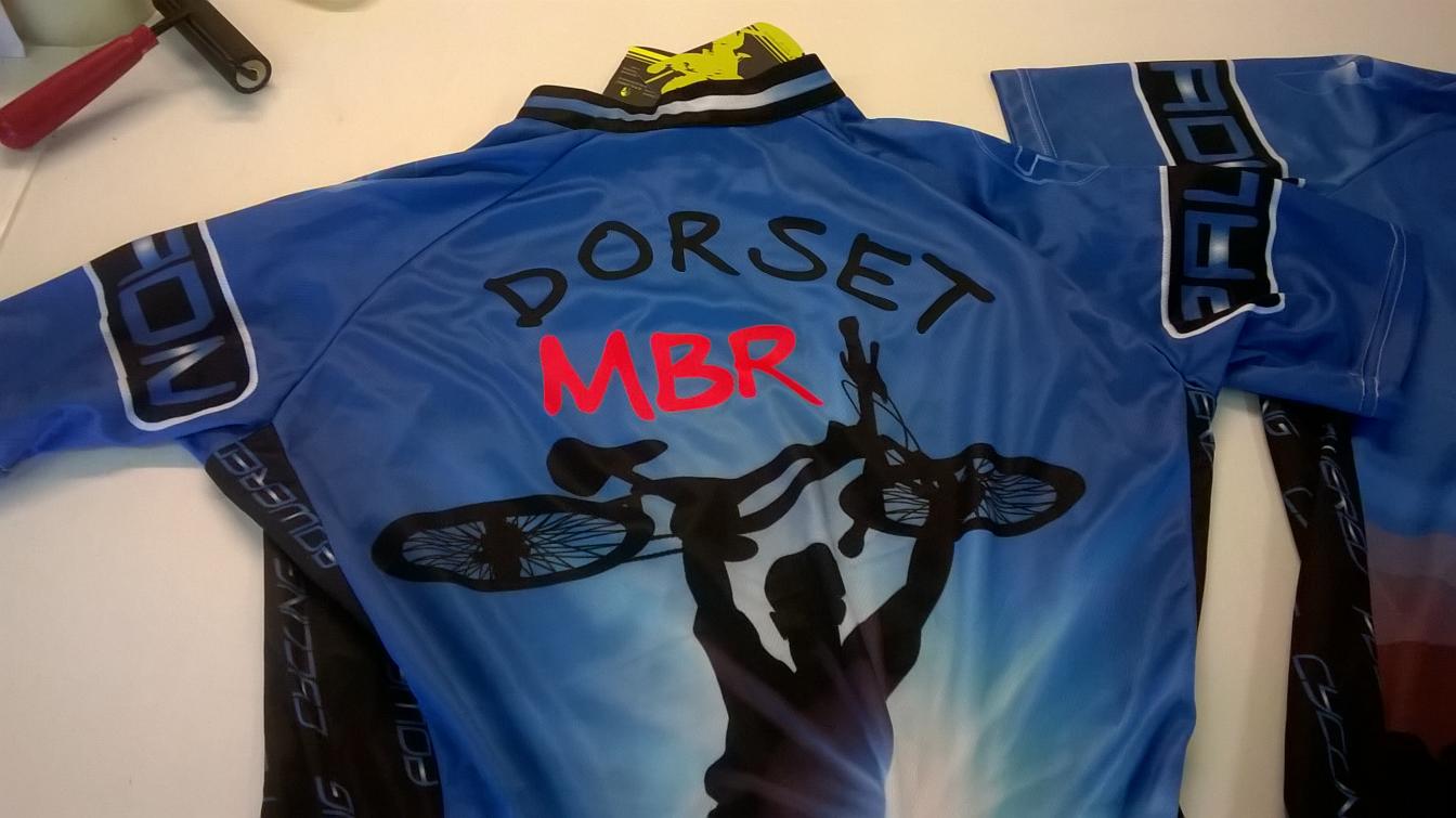

There should be little or no effect. I have printed onto sub printed cycle jerseys in the past at 160c/15secs without problems. The temp is at the bottom of the sublimation range and the time is short so there will be very little gassing.
Just inform the customer that there might be a slight discolouration and use a pillow to reduce any unnecessary contact area.
The text in the image was added to an all over print.
