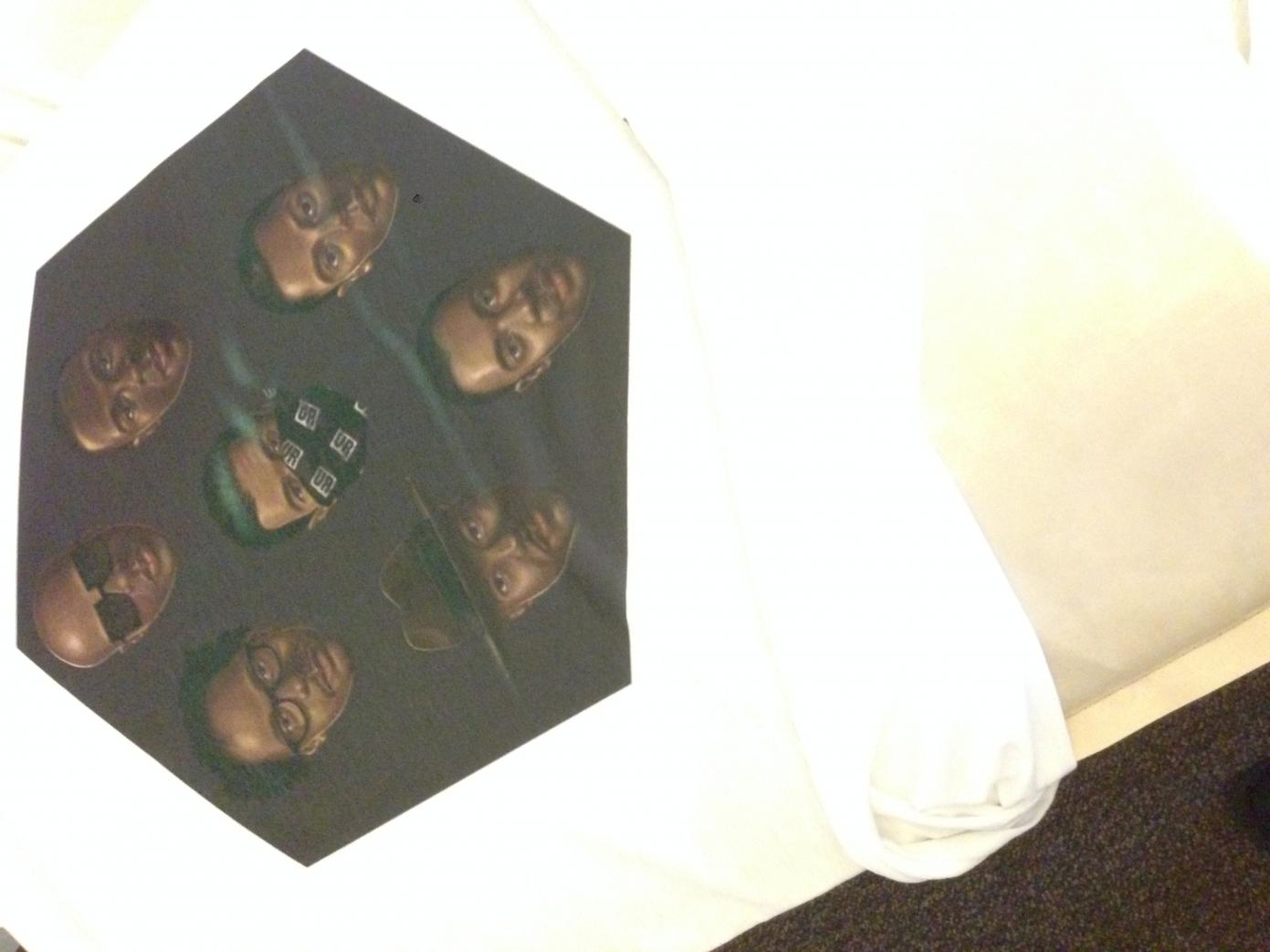

Hi,
having problems printing flat colour:-
Using a teflon pillow inside the tee.
this is the result...
vB_ID:4872
vB_ID:4872
not experienced this before. strange. Any ideas why? HELP!
logobear
Posts: 1694
Joined: 08 Feb 2010, 14:03
Re: flat colour T-print fail... light, cloud bands across it.
Post by logobear »
don't use the pillow, it creases and gives uneven pressure
