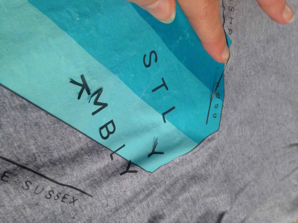

Hi folks, Ive done a few shirts where I've printed a 3 color logo using 3g jet opaque, over the top of that and out with the logo is mdp hotflex vinyl, the customer has come back and said that the lettering has came off, anybody else had this happen?

Post by paul 44 »
here is an image of the shirt and where the lettering has came off

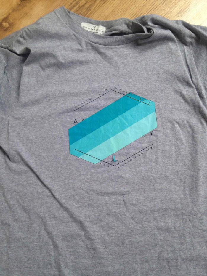

Post by paul 44 »
here is another image of another shirt, the vinyl has adhered to some parts but not others as you can see from the 2 images
