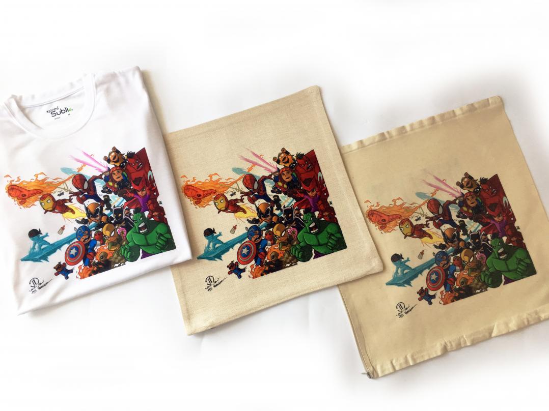

This image is a good example, all printed using the same ink, same printer, same paper, same software, same heat press. But the products are different materials / texture and colour and you get a differing result.
Alex
