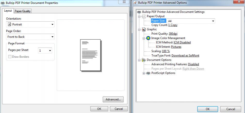

Here are the settings I use in the BullZip PDF Printer dialogue ...
vB_ID:5829
vB_ID:5829
I haven't provided any printer driver settings for Photoshop as I use Ricoh printers.
