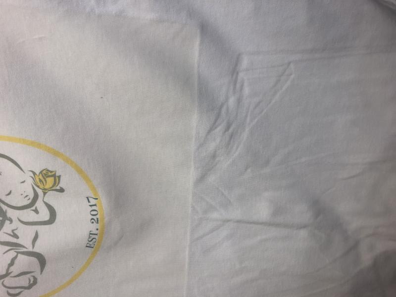

A look at how it is

Is that printing a yellow tint to the paper?
So when you print does it print just the image and then spit the paper out.
Or does it continue for a while then spit the paper out?

Have you been printing hi-vis or bright coloured polyester?
Is your cover paper leaching something onto the fabric when pressed?
