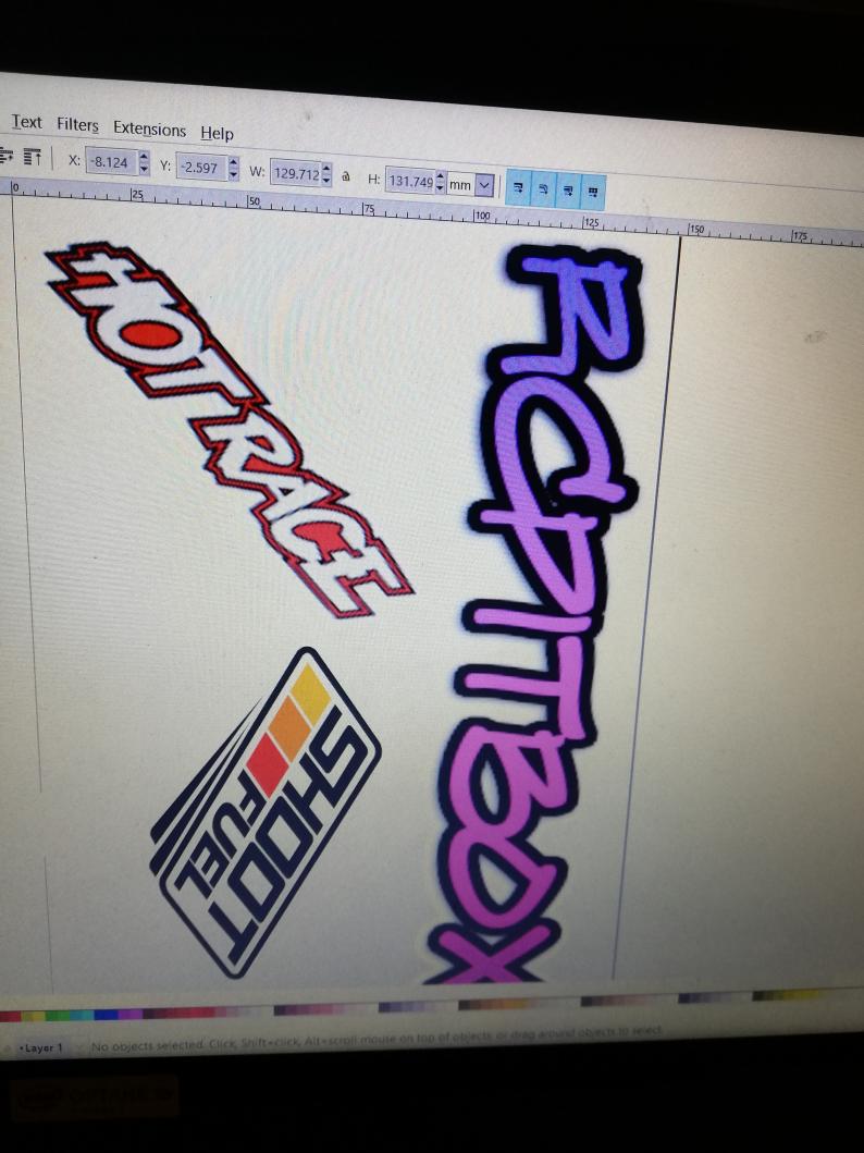

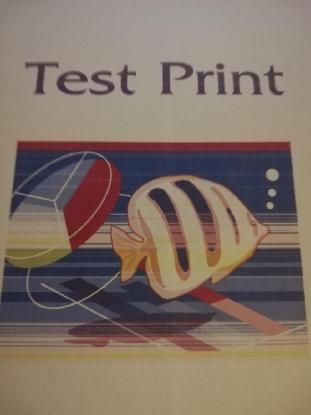

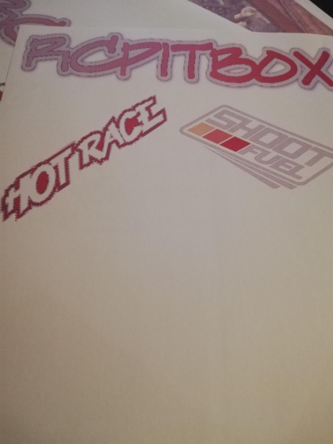

[ATTACH=CONFIG]5931[/ATTACH][ATTACH=CONFIG]5929[/ATTACH][ATTACH=CONFIG]5930[/ATTACH]some pics of the print and design

Re: black not back more like grey
Have you pressed any prints yet?
Post by Gr3g0rs »
i have but it was before i put the icc install and was even worse than these
The colours on the printed paper won't always reflect the final printed colours. What inks are you using?
Post by pw66 »
Are you using CMYK or RGB colourspace. Always use RGB.
Post by InkExperts »
Do you have a nozzle check pattern from the printer you could post?
The test images appears to be banded which points towards one of the nozzles not firing correctly.
If you can send the image of the nozzles I'll try to troubleshoot from there.

thanks for the reply
ive just fired it up and the waste tank is full, i uses a lot of cyan little magenta but hardly any yellow could this be to blocked nozzles
once i got this clearded ill do the nozzle print check
thanks
Definitely sounds like blocked nozzles.
Any joy with a new waste tank yet?
