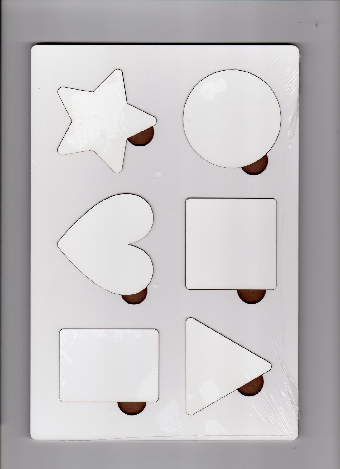

Morning all,
I was just wondering if any of you happen to have a template for the toddler's wooden shape puzzle?

Take a photo directly above the puzzle and use it in Photoshop to make your own template by calibrating the PS screen measurements to match known dimensions of the puzzle.

webtrekker;142625 wrote:Take a photo directly above the puzzle and use it in Photoshop to make your own template by calibrating the PS screen measurements to match known dimensions of the puzzle.
I remembered I had a scanner packed away so dug it out and went a similar route.
And for anybody who wants it...
[ATTACH=CONFIG]6150[/ATTACH]
Now I'm just looking to see what other flat items I have without templates:+)

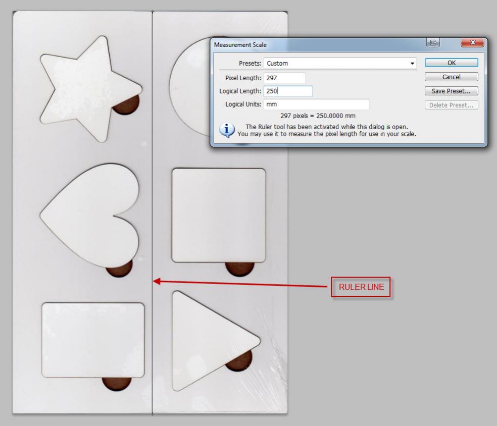

Re: Wooden puzzle template?
This is a good way of making your own templates. Once you have a good image and have cropped and aligned the vertical and horizontal edges, simply add a Ruler line to a known size (in this case the length of the puzzle, which I've just guessed at 250mm), note the length of the line (in this case 297 pixels) then go to Photoshop's 'Analysis --> Set Measurement Scale --> Custom...' menu entry, select it and enter relevant sizes in the dialogue box ...
[ATTACH=CONFIG]6151[/ATTACH]
From now on, any measurements will be to the scale of the actual product.

webtrekker;142627 wrote:This is a good way of making your own templates. Once you have a good image and have cropped and aligned the vertical and horizontal edges, simply add a Ruler line to a known size (in this case the length of the puzzle, which I've just guessed at 250mm), note the length of the line (in this case 297 pixels) then go to Photoshop's 'Analysis --> Set Measurement Scale --> Custom...' menu entry, select it and enter relevant sizes in the dialogue box ...
Thanks for the tip:smile: - I shall have a play.
