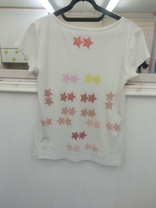

Using Ricoh sg3110dn printer and using photoshop have nearly tried every combination of heat and time but i still get Brown instead of Black
Someone please help :frown:
[ATTACH=CONFIG]6293[/ATTACH]Brown stars are supposed to be black !

What brand of inks are you using and do you have an ICC profile for them? Also, what are your pressing times/temps and are these shirts 100% polyester?

To the question above inwant to add is your heat press calibrated and showing the correct temperature, do you use real sublimation paper?
