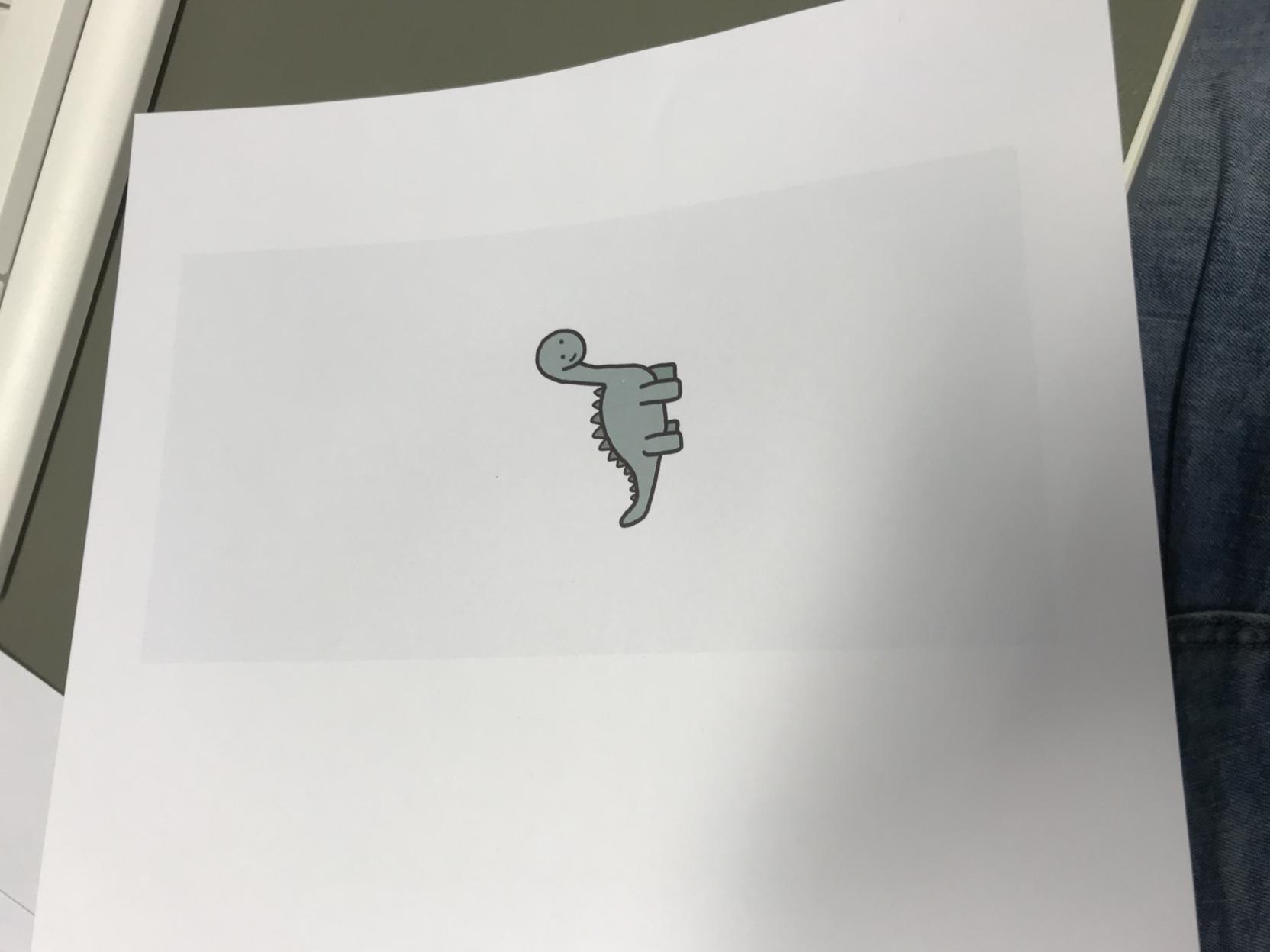

[FONT=&quot]Hello,[/FONT]
[FONT=&quot]iam newbie of sublimation. Iam still learning and i do it for my family as a hobby.[/FONT]
[FONT=&quot]My sister want to print [/FONT][FONT=&quot]
Image[/FONT]
[FONT=&quot] but it looks like that [/FONT][FONT=&quot]
Image[/FONT]
[FONT=&quot][/FONT]
[FONT=&quot]Totally withou green. I print out from photoshop.[/FONT]
[FONT=&quot]use epson l3110 jteck jtech inks sublimation paper.[/FONT]
[FONT=&quot]Thank you for your help[/FONT]

[ATTACH=CONFIG]6436[/ATTACH][ATTACH=CONFIG]6437[/ATTACH]
images

Re: Color issue - Epson L3110
Do you have an icc profile installed?

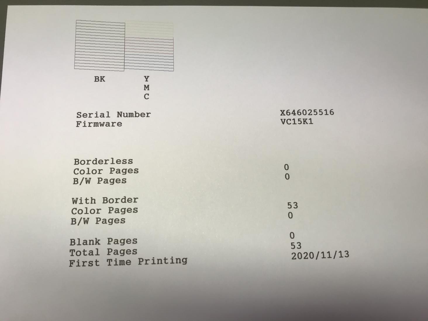

[ATTACH=CONFIG]6438[/ATTACH]
Sure, here it is. :)
vB_ID:6438
vB_ID:6438
Thanks. Your nozzle check looks fine.
Can I ask what colour mode you have Photoshop set to? Is it in RGB mode or CMYK mode?
Secondly, although you say you are using an ICC profile, have you set colour management in Photoshop to allow Photoshop to manage colours, and have you turned off colour management in your printer settings?
I have also added this reply to your same question in the t-shrt forums...
Have you tried pressing it yet? Colours on sub paper are always totally different to the final pressed colours.

I have just been sent an ICC profile for this ink by the supplier - if you message them onAmazon they’ll send it to you - unless I can upload it here somewhere somehow?
