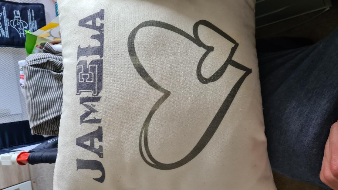

Hi Justin, Thanks for your reply i'm using a epsom p800 with titan x paper with sublinova ink. I'm also using a custom icc profile from ink experts, so shouldn't be a problem. Yes the sacks are 100% white polyester, I had the same thing with some pillow cases. the black seems to come out green.
I will upload a pic.[ATTACH=CONFIG]6445[/ATTACH]
On photoshop they both looked the same colour then on printing it changed. also the printing was patchy but i believe this to be moisture so I pre press for longer.....Any ideas of the best way to practice can I buy polyester on a roll, I don't want to be buying these all the time. Also will all polyester bobble like that looks rubbish.

1. In Photoshop move the mouse pointer over the colours and check in the 'Info' panel that they are pure black , rgb(0,0,0) or #000000. Make sure your document is in RGB mode and not CMYK.
2. Yes, you can buy white, 100% polyester fabric with a range of finishes by the metre or by the roll from numerous outlets. Then you can either print then cut & sew, or cut & sew then print. Use a lint roller before printing for best results. As for temps and times, 190 deg C for 60 secs is a good starting point.

Re: Sublimation print problem
Another simple check.
When you click print and the print preview box opens does it state photoshop manages colour and the icc profile name is selected?
also check that the colour correction options are off.
Mr tea yes and yes, this is why it has thrown me. I have been going through checking my settings but maybe as webtrekker has said I will start to check the colours before printing.
