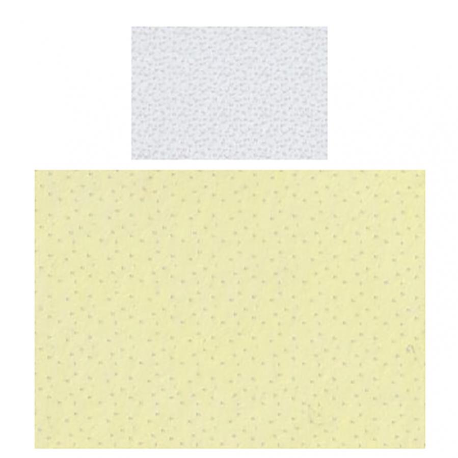

Thank you for your reply. I'm also using a very light pressure and copy paper (two sheets top and bottom). Since my previous post I've taken a closer look at my actual print outs (from Sawgrass SG400) and have discovered that this effect is actually many small dark dots. It's definitely not a dust issue as I have printed the same image a few times at the dots appear in the exact same place. I've attached a close-up of a scan of the printed page. The image shows what should be a white square and a yellow square. In Photoshop, zooming right up close to the original image shows pure white and yellow with zero dots.
After a little bit of googling I'm thinking this is some kind of "dither" setting, but I don't really understand how that works! I know that in my printer settings dither is set to "automatic" at the moment.
Any advice would be appreciated. I suspect this problem has always been going on when I print mugs, but because the images are smaller it is almost unnoticeable on them, but on larger metal prints it is very clear to see.

What model of printer are you using? Dithering can be a problem on printers with only 4 colours (CMYK). Is the resolution of your original image adequate, ie 300dpi or more without scaling?
Re: Stippled/waves effect on yellow colour.
Printer is a 4-ink Sawgrass SG400. My printer resolution is set to 600 dpi. My original images are all done at 300 dpi. I'm also printing via Photoshop.
