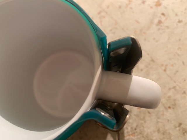

Don’t seem to be having ANY luck at the moment.
We have noticed that the green wraps we are using are staining the mugs where the mug isn’t protected by paper. We have tried adding an extra sheet of paper in between the sublimation paper and the silicone wrap but then that seems to be causing our slight blurring issue (as the silicone wrap isn’t getting pressure to the slight dips in the mugs).
So, we are now covering much more of the mug with tape but I wonder if there’s any obvious reason why the wraps would be staining the mugs (they are brand new wraps).

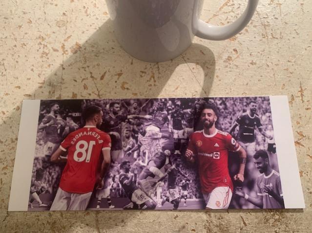

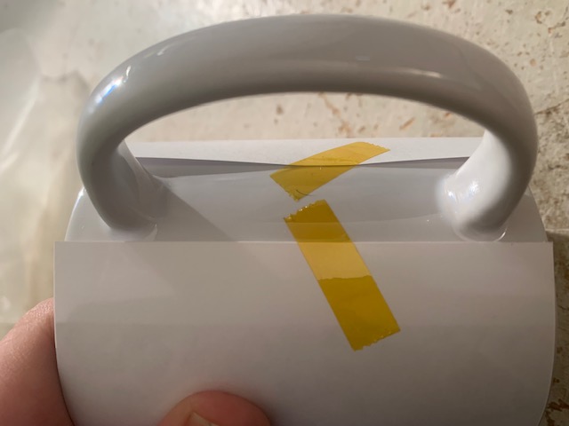

[ATTACH=CONFIG]6776[/ATTACH][ATTACH=CONFIG]6777[/ATTACH][ATTACH=CONFIG]6778[/ATTACH]
Image one shows how my prints come out of the printer. Image 2 shows how they are taped and image three shows with wrap attached.
I found that it is really important to have the paper extend beyond the wrap. So on my mugs the paper is 240mm wide. It is also important that you have clean wraps (which you seem to have). I tend to give my wraps a "cook" to gas off after about 20 odd prints or if I have done a design that has been really heavy on ink (such as the one illutrated)
