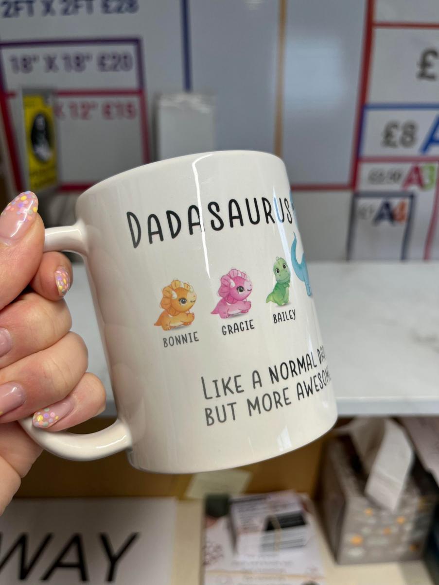

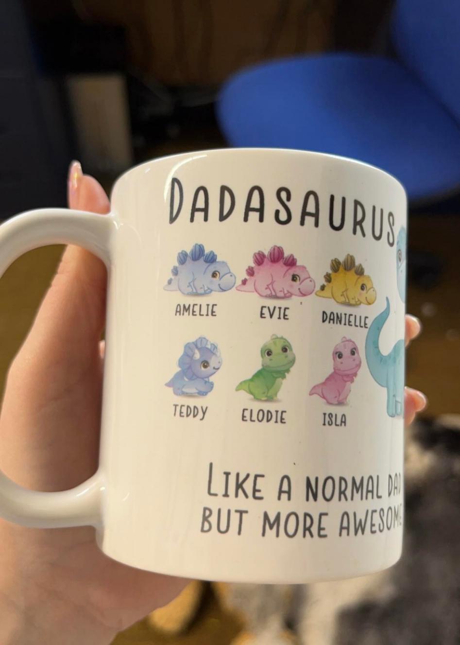

Hi All,
We are currently using the J Trans automatic mug press. We have a Ricoh AficioSG700DN printer and use Sawgrass Sublimation Ink Sublijet R.
We've just got our machines temperature gage calibrated and new blankets on. But our 11oz mugs are showing a fade out at the bottom and edge, even though the artwork is well in from the blankets edge to ensure the heat element reaches it. When we do our 15oz mug in the same press it comes out perfect.
As the press is automatic we cannot adjust the pressure and was not sure if this would be the problem, but surely as it's automatic it should gage the correct pressure?
Images attached below.
[ATTACH=CONFIG]6912[/ATTACH] [ATTACH=CONFIG]6913[/ATTACH]
Any suggestions would be extremely appreciated as we are binning mugs in the dozens as some are coming out fine and others not.

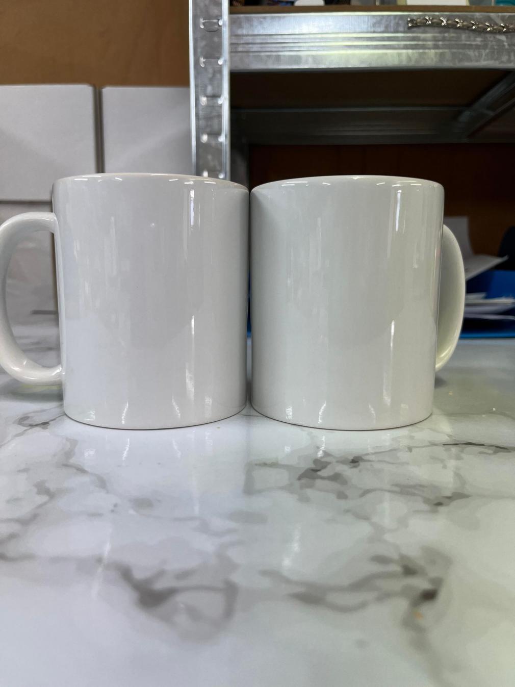

Which brand of 11oz mugs are you using? Have you checked for distortions by standing 2 mugs together, touching each other, and seeing if there are any gaps between them?

webtrekker;150826 wrote:Which brand of 11oz mugs are you using? Have you checked for distortions by standing 2 mugs together, touching each other, and seeing if there are any gaps between them?
We've check this and yes, there is the bottoms of the mugs do not touch compared to the top that does. (see image) We've got some new mugs and they are so much better but there is still the slight fading in the same area.

Re: Fade at Edge & Bottom of Mug using automatic mug press
