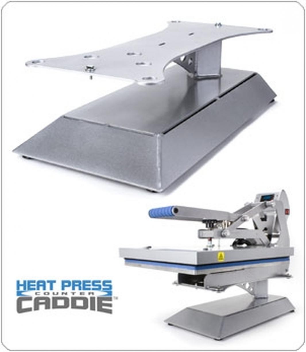

In that case buy the Counter Caddie for the press It will raise it up and make it threadable. About £150 from MDP Supplies. You will then probably not need tape.
You really want to get the transfer away as quickly as possible. the image will continue sublimating until the temperature drops.
If you have problems with ghosting - due to the fabric contracting - use sticky sublimation paper.[ATTACH=CONFIG]6935[/ATTACH]
