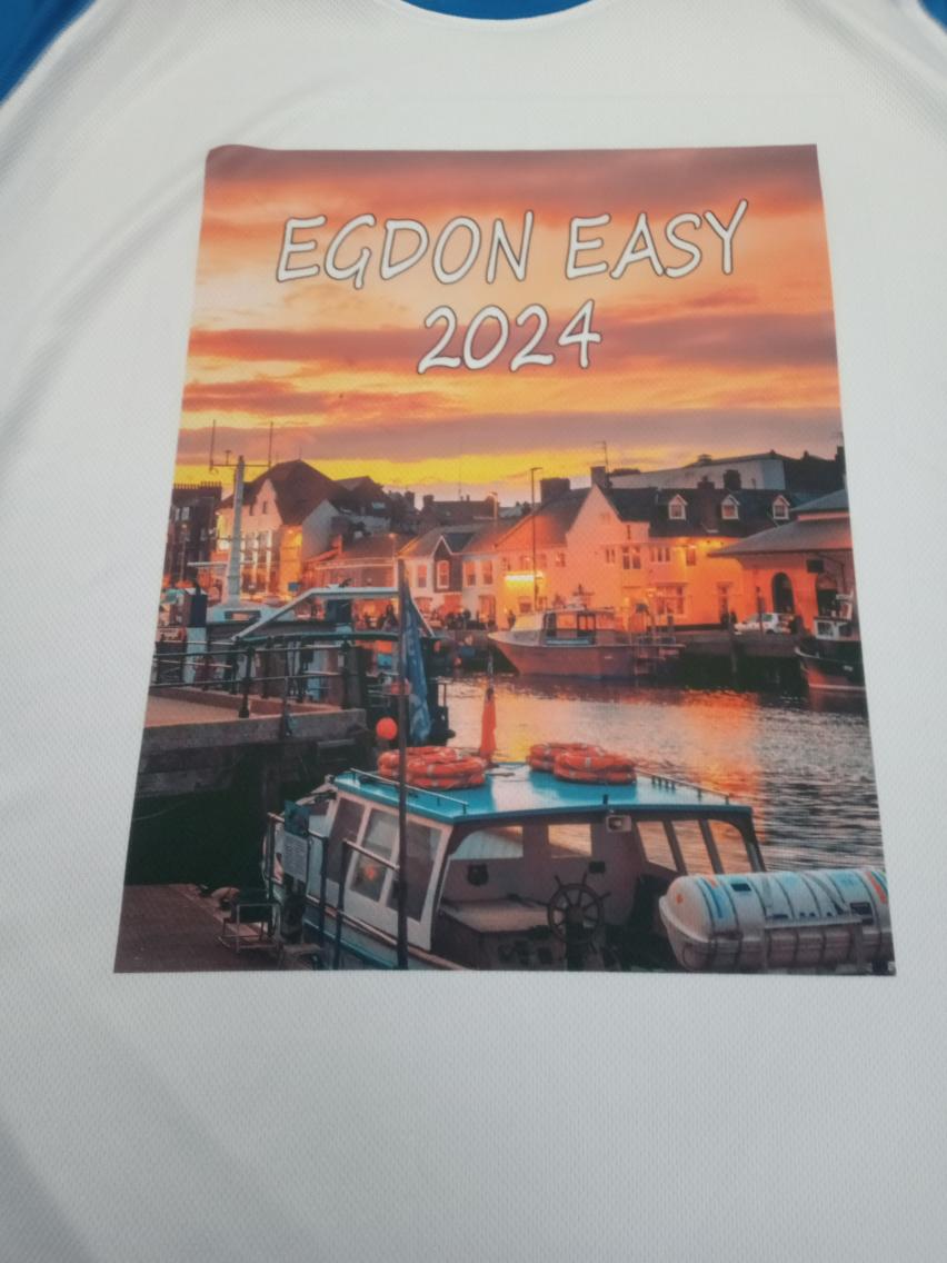

If you can't get a profile for your 970 then this is a good cheap option for A3 or occasional A3+. (Below - about £250 for printer, ink, profile and carts)
Printed 280 full colour A3 transfers last week for a fun run t-shirt. Didn't miss a beat for two whole days of non stop printing - no miss feeds and printed about 22 sheets an hour, which is much faster than a photo printer would manage. Only needed to fill carts twice a day, so not particularly ball breakingly time consuming.
[ATTACH=CONFIG]7347[/ATTACH]
https://www.printerland.co.uk/product/e ... ZIQAvD_BwE
https://www.inkexpress.co.uk/product/in ... c-profile/
https://www.inkexpress.co.uk/product/co ... set-empty/
