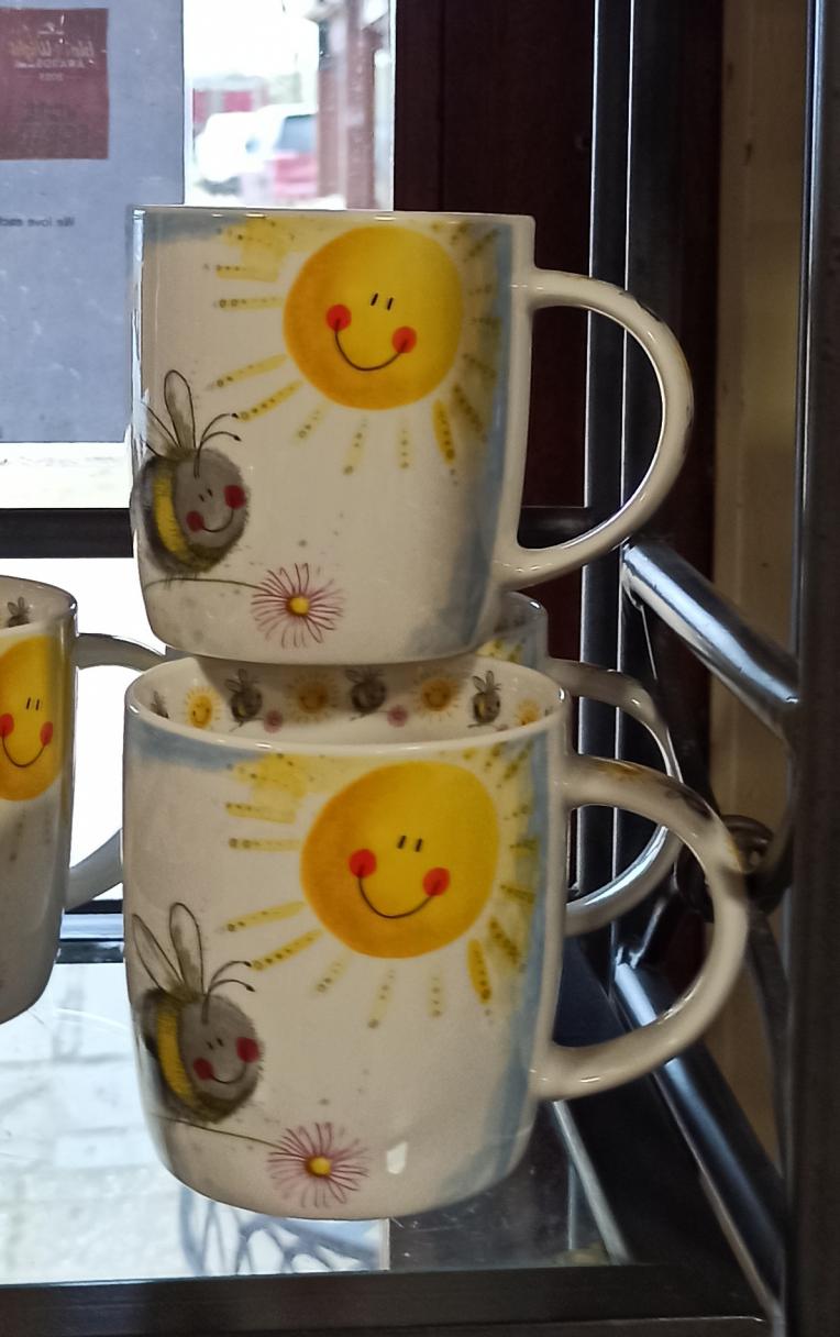

Looking at alternative print methods for mugs and other items.
Attached image for reference. Not sure of this is water decal transfer.
Appreciate guidance on suppliers or preferably techniques used.

[ATTACH=CONFIG]7426[/ATTACH]
Example image.

Water slide transfers, especially those designed for ceramics, need to be kiln fired after application to properly fuse them onto the ceramic piece and make them permanent; essentially "baking" the decal onto the surface with heat from the kiln. Do you have one?

Yes appreciate we would need a kiln, would be looking to get one.

UV DTF? You already have the presses. Order in by the linear metre to save the £20k for a machine.
