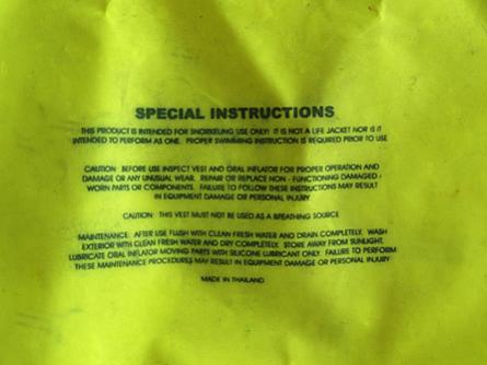

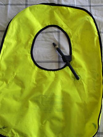

Hi Guys & Gals, This is a pic of a snorkling vest that a client of mine wants to have his logo on. Anyone have any idea if this is a polythingy material that could be subbed?

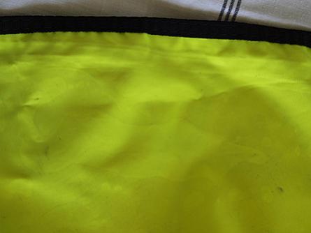

Is this a lifevest of some description? Any idea what the materal is? It may well be able to withstand a vinyl if it's nylon or if outer is polyester then subli yes but I'd be very careful with it.

Thats the problem Justin I'm not sure what it is made of. It is a life vest. Not sure what they are made of. All I know is its made in Thailand.

Just done a google and found similar item saying made out of 210 dennier nylon.

Nylon vinyl would prob work, bit expensive to test one though I would think! You wouldn't want to put anything on it that may hinder the safety of the life saving side of things

Justin, would you think then that the type on the vest has been silkscreened on?
Posts: 12090
Has thanked: 11 times
Re: Is this sublimatable?
I would have thought so, perhaps the safest option.
