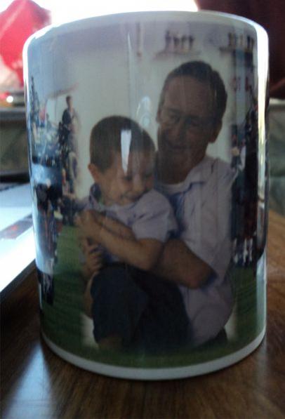

I have a big struggle to make a good quality mug. I read the forum, tried to follow instruction, but nothing good comes out.
Could anybody help me to find out what exactly is wrong.
Please, see the sample of my "best" mug so far.
[ATTACH=CONFIG]610[/ATTACH]

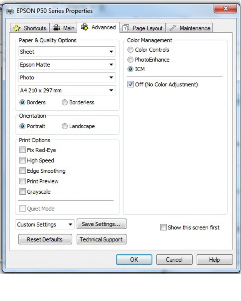

Corel Draw Default color Management settings : RGB color profile is set on SP T50 P50 T60 Standard
After pressing File>Print>Properties I choose Photo print on Epson Matte Paper. In advance tab I choose Color Management ICM and off (no color adjustment). Here is the photo
[ATTACH=CONFIG]609[/ATTACH]

Recomended way is to use 180C for 300 sec if the press is cold, and 180C for 180 sec if the press is hot. Which doesn't work.
After reading forum I've done different, I preheat the press with extra mug until 190C and then put my mug on 190C for 200 sec, which were my best settings so far.
Third, getting the result
Nonesense.
People have a grey skin, image is not bright.

Hi anna. You need to use icc profile. You need it to tell your printer how to mix the colours to get great results. Standard printer profile is no good. Also in printer driver i would think edge smoothing and high speed. Also check if you print on correct side of your oaper. Ps. Link to your mug does not work.

First thing we need to establish is what paper you're using and where it came from. Next, we need to know what sort of ink you have. If this ink (as I suspect) is third party and not supported by Sawgrass, we cannot discuss this here.
The P50 is a fantastic printer for sublimation but as Paul has mentioned, you need the correct profile for the inks.papers you're using.

[ATTACH=CONFIG]611[/ATTACH]

Can you post a photo of your mug press? You're obviously using sublimation paper as the image is there and the colours don't look toooo far off, it just looks washed out which could be the press/heat settings.

I'm just wondering if giving the D88 profile a go might improve the colour a bit. It just may brighten things up enough & doesn't cost anything to try.

worth to have a go with ready made one. can we see the photo before it when on the mug?? so w eknow how far is off...

I've sent a profile to Anna so that she can at least get that bit working right, I'm still thinking it's more to do with the press though.
