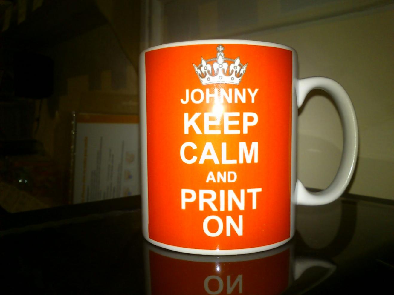

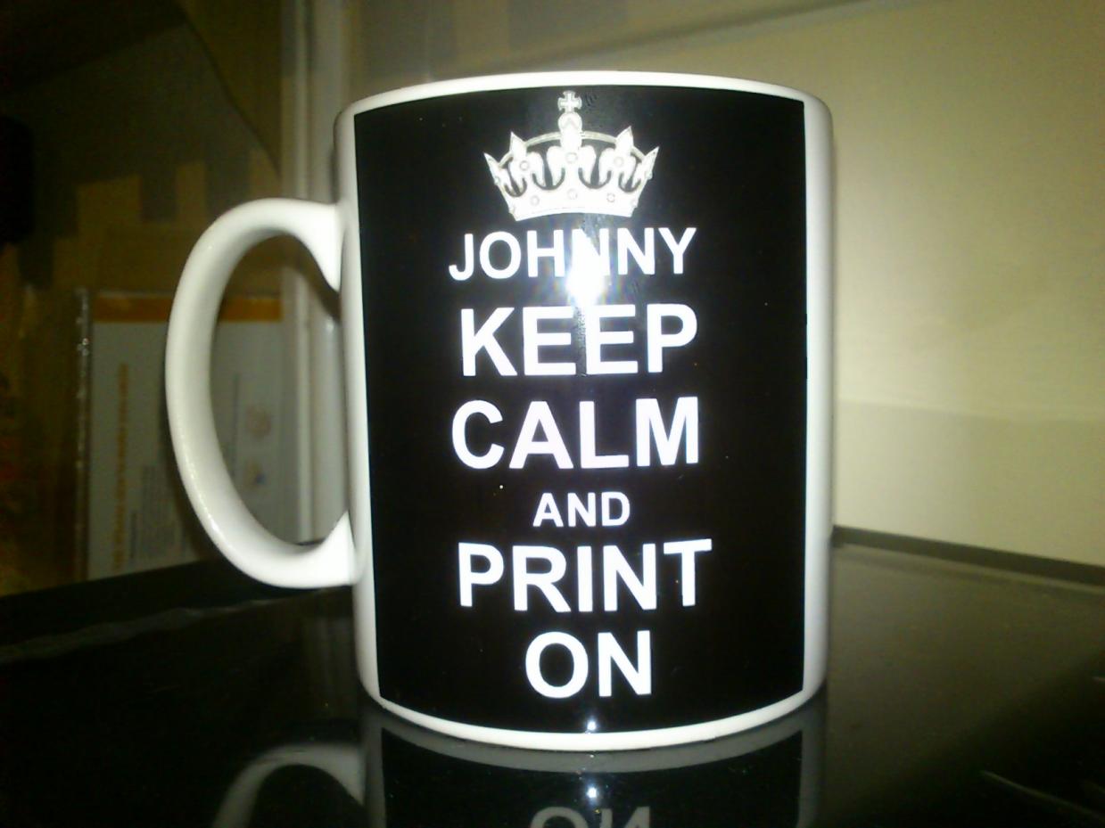

bms;57811 wrote:Settings should be: idle temp 110 degrees, mug in and press start button, operating temp 170 degrees, time 140 seconds. Blacks going brown is too high a temp for too long (temp settings are for Ricoh printer and SubliJetR inks, Artainium inks would require 180 degrees).
i dont use idle martin - set for 170 for idle and printing...i just put blank mug in while heating, then whip it out 2 secs from 170....insert printable mug and press start
lowered the temp to 170c - time to 175sec.....yes.
back to good again....
really strange i had been using 180 and 180 since day one......could be something to do with inks settling ?
[ATTACH=CONFIG]1270[/ATTACH][ATTACH=CONFIG]1271[/ATTACH]
excuse the camera flash !!
