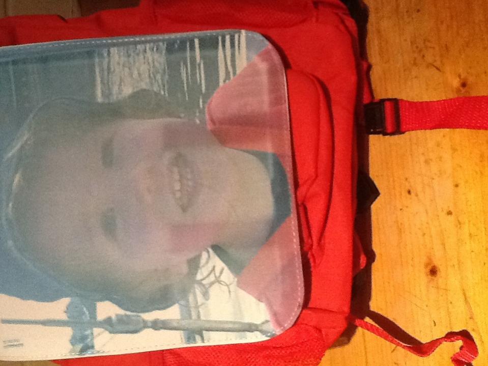

Bought a small children's ruck sack from bms, really happy with it but when I come to printing the picture the 2 Velcro straps which are fixed underneath ruined my print. How can I over come this next time? Does BMS sell the separate sub flap individually so I don't waste the bag

Yes, you can buy separate flaps :-)
What time/temp/pressure are you using?
Re: How can I stop this?
you need to prepress them before you press to get rid off all moisture. then i would use HEAVY pressure.

I used the settings off bms web site which were 190 for 65 sec.

Has anyone else ever had the Velcro come through? How do you think I could stop it happened next time? Maybe press slightly lighter?

Yes you can remove the flap for printing which i did. But so that the flap sticks to the bag there is velcro on the revdrse side which has come through when pressing.

Use a piece of thick card the size of the flap with cutouts where the velcro is, making everything the same level.
