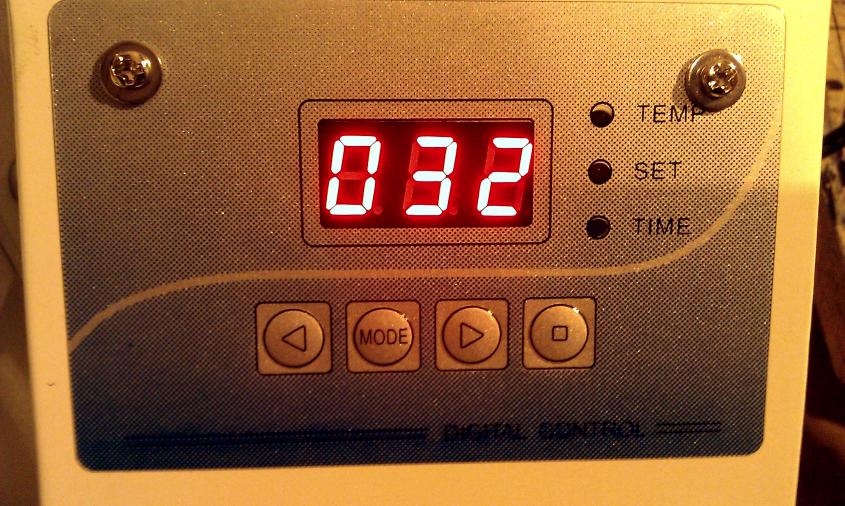

Re: Understanding my new Heat Press instructions for temp & time setting
..and we're not?!?!?!? lol, not actually. Could do with a pic of the controller to show us which model it is.
Si Da Signmaker
Posts: 25
Joined: 06 Dec 2012, 10:47
Post by Si Da Signmaker »
Here it is,
[ATTACH=CONFIG]1378[/ATTACH]
vB_ID:1378
vB_ID:1378
OK, not an awful lot to go on, maybe someone will recognise and be able to help, doesn't look overly complicated. No model numbers etc?

Si Da Signmaker;61644 wrote:Here it is,
This looks similar to ours so here goes. Settings differ for mugs and for flat press.
For flat bed press:
1. Press Mode button and this will set the 'idle temperature'. Set this to 190-200 degrees (if in C) or 374 (if in F). buttons decrease/ increase.
2. Press Mode button again and this will set the 'operating temp'. This should be the same as (1)
3. Press Mode button again and this will set the time. Set this to 60 seconds if that's what you need for the time.
4. Press Mode button again and you get back to the start
The press will heat to the 'idle temp' and give a 'beep beep' when reached and it will stay at that temp. Press the far right button to start the timer once press engaged. The press will rise to the 'operating temp' and then count down.
If using the mug attachment then the idle temp should be set no higher than 110 degrees (in C), 230 degrees (in F), operating temp should be 170 degrees (in C), 338 degrees (in F) and time of 140 seconds (assuming your using a Ricoh printer).
Further non chinglish instructions here http://www.printerowners.co.uk/docs/df18manual.pdf
