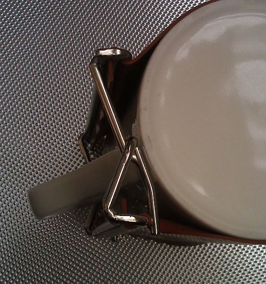

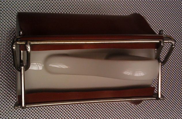

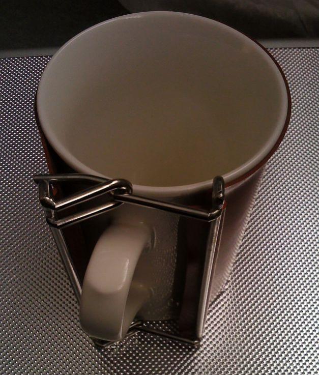

I bought an oven wrap to try out on some china mugs I have. Its a pain to do these in my normal mug press so thought I would try the oven method.
Anyway I got this from the Transfer Press and well check out the pics. Have I done it wrong ? Around the handle there is just a massive gap ! And it is a bigger pain in the arse to set up than the mug press.
It does fit snugly around the curved shape of the mug though.
I emailed them a few days ago but well I guess they don't wanna know , ha !
Anyone know of any alternatives that fit better around the handle ?

It is put on wrong. Clasp should be the other way around but also not sure if the silicon is on the clasp correctly. Got some in work so can take a look in morning if you do not get it sorted before.

Yep ass about face, and I can laugh because I spent hours (literally) with a bottle of wine trying to sort this sort of clasp out! Just put them on the other way around ..... have a bottle of wine first, it then becomes really obvious!

Andrew;69170 wrote:It is put on wrong. Clasp should be the other way around but also not sure if the silicon is on the clasp correctly. Got some in work so can take a look in morning if you do not get it sorted before.
I will try it the other way around in the morning.. mind you if the silicon is incorrectly on the clasp, i'm doomed ! .. even wine won't help me
