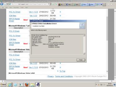

I have downloaded the raster zip, unzipped it followed instructions and when it gets to the copying files bit, It says failed and wont copy, ive tried from the disc that came with printer as well both failed. any ideas? [ATTACH=CONFIG]1763[/ATTACH]

Its ok, sorted, it was an administration problem, had to do this http://www.addictivetips.com/windows-ti ... ownership/ in case anyone else has problems with this.
