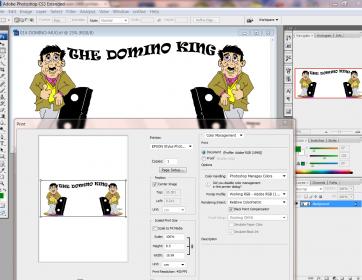

in colour management i can scroll down all the profiles are there including the new downloaded artainium but in photoshop the artainium can not be found i have added a screen shot[ATTACH=CONFIG]1764[/ATTACH]
i think i may have to uninstall and start again i think justin

Screenshot a bit small but I assume it just isn't appearing on the list...and therefore isn't installed?
