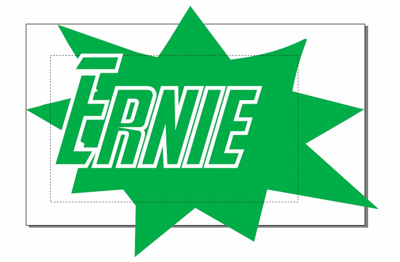

I have a design for a wall decal but I have no idea how to go about cutting it. it is a name ontop of a shape but I need a border around the name (as you will see in the pic) and I need the shape to not be visible on the lettering if that makes sense.
this is probably basic but I haven't done anything like this before.
thankyou in advance for any advice

Re: vinyl wall design, need to know how i would go about cutting it???
put it in the cutter and hit "cut"! as simple as that. if your wall is white then border will be colour of your wall. you can also cut the border from the white vinyl and layer it.

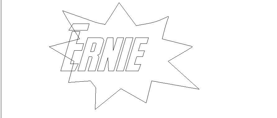

I tried exporting from corel to artcut as I usually do, and this is what it will look like if I cut it. it doesn't have the space around the name like it should.
is it made of strokes? try to brake it all in to curves and use welding tool.

I think so, I just imported a basic star shape from the corel shape menu, I then added a text box, wrote the name, chose my font, and placed it where I wanted it and then put the shape behind the text. then I put the outline of the text as 16 points in white. usually at this point I would hairline everything and put no fill and then export to artcut but I cant put the outline of the name at hairline because I need it to have that thick border so it will cut the name and then I can weed that border around it. if that makes sense.

Post by Skye »
Give the text the 16 point outline. Click on the text, then go "arrange" - "convert outline to object". This will create a new object which is just the 16 point outline. Give this the hairline outline.
You will probably need to use "arrange - combine" or one the "arrange - shaping" functions to amalgamate this with the star.
Post by arko »
As Paul said, I think its a case of "combining" both shape and text and then "welding" them together.
RogerC
Posts: 835
Joined: 09 Feb 2012, 14:49
Post by RogerC »
In Corel go to arrange....select shaping then weld and you should have the image you require. Check it in wireframe format and you'll see the lines that will be cut.....simples.
