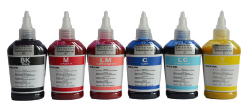

im using the ink in the photo {edit: image removed by admin}

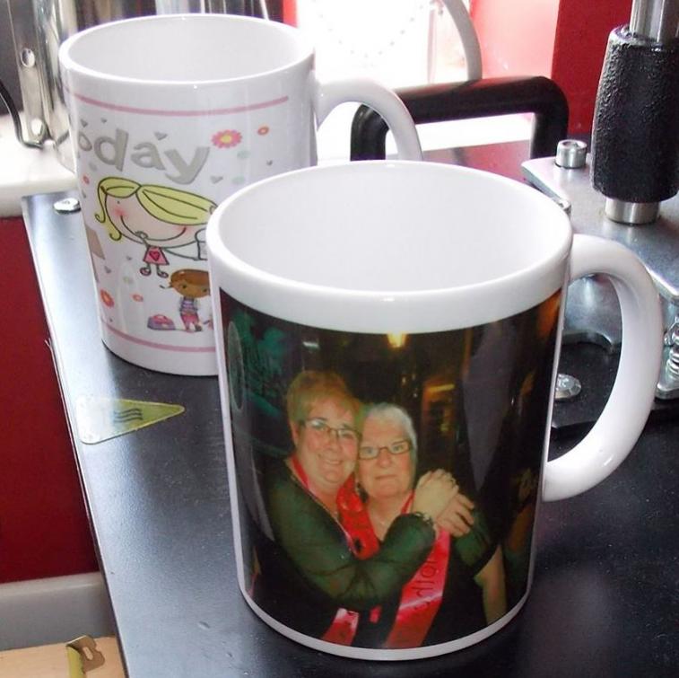

I tried dyesub paper as well but getting this problem with mugs ive printed
getting a tinge on peoples hair and the mug at rear should be like this
im more concerned with the tinge im getting fro people than the kids
birthday mug as im getting tinge on everything I print

That's cheap unlicensed Chinese ink.
Without an ICC for that ink and your 1400 printer your colours will not be right.
Either get some decent licensed ink (with an ICC) or get Paul from this forum to make you one.
