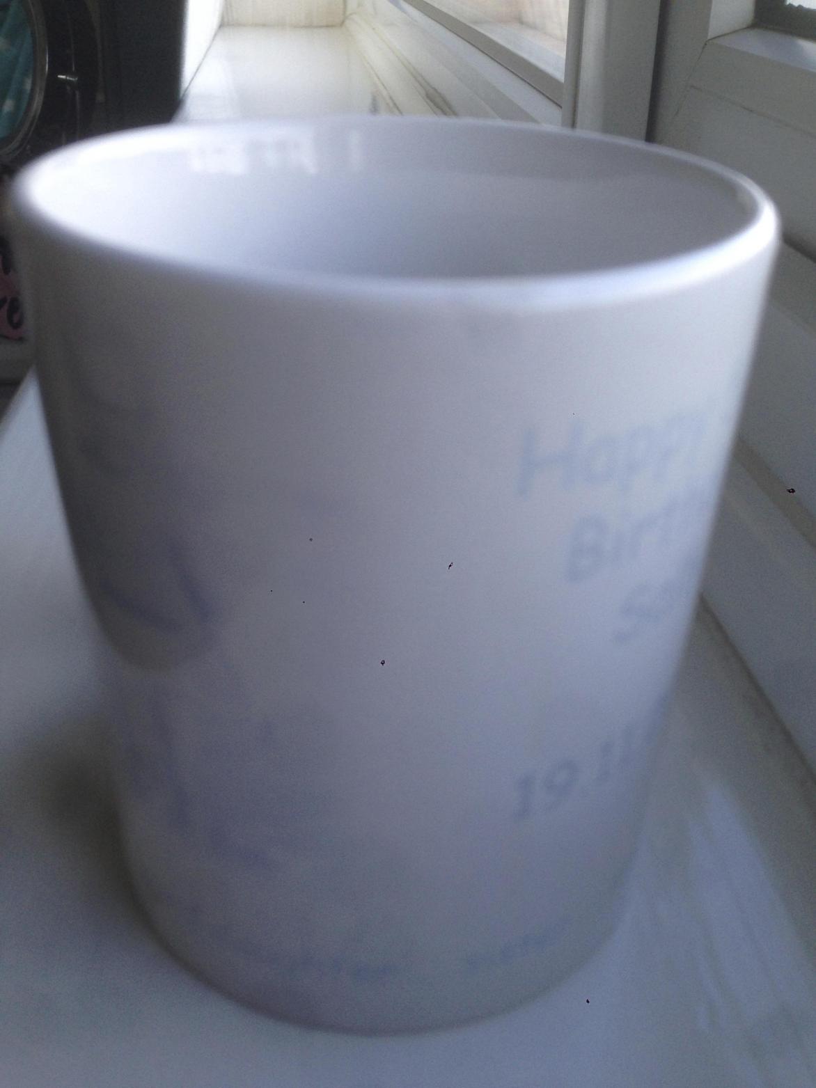

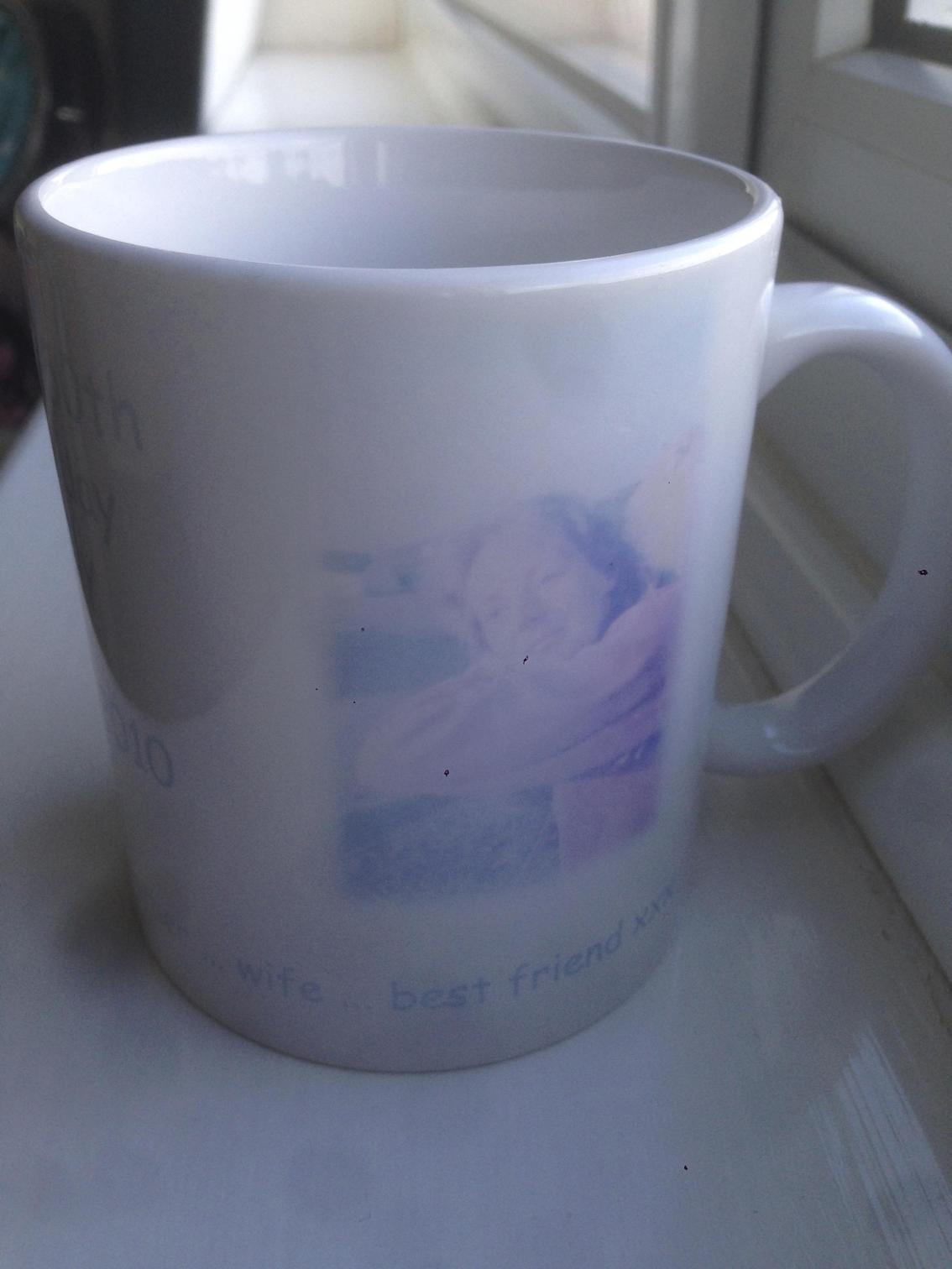

Just thought I'd post this! A friend bought a printed mug 4 years ago. He just asked me why it's faded like this. It's clear to see that the cheaper mugs and/or inks don't really last! I've just printed him an identical one using RN coated mugs and the Ricoh printer. He's obviously over the moon with the difference.
Just thought I'd share it!

Not all sublimation mugs are dishwasher proof, or even wash proof really ... also, are you sure that that mug is sublimation?

Well, he bought it from an eBay seller 4 years ago as a "Sublimation mug" and it was quoted as being "suitable for use in a dishwasher". He said it was vibrant - for a few months!
