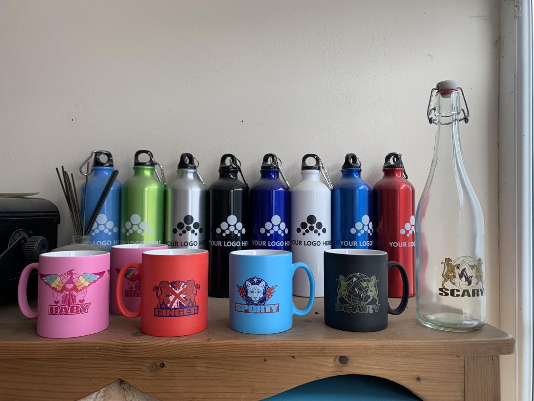

There is a way to do it that is relatively easy, and if for home use is a way to go...
Contract out to someone who can print using a White toner based system. They can print on a paper that is known as HARD SURFACE LIGHT. They can print your design which can then be heat pressed on to your glass (assuming you can get your glass into a heat press).
Once printed this will withstand hand washing ONLY. However, you can also get a varnish to give a light spray over the whole image which will mean it withstand a dishwasher. The below image has a glass bottle that I was tasked with. The end result was really quite durable.
For the record, I can print on hard surface light, however my white image drum is running very low meaning there will be too much residue left in the blank area for me to be satisfied with supplying you. However there are others on here that can probably do it for you.
[ATTACH=CONFIG]5935[/ATTACH]

Re: Vinyl for Glass
I'll check that all out, thank you.socialgiraffe;140345 wrote:There is a way to do it that is relatively easy, and if for home use is a way to go...
Is the white toner, like the transfers people do on oki printers etc?
The pint glass I used for testing sublimation fits into my mug press, and is toughened so can with stand the heat etc.
Do you have a name of the spray?
Sent from my SM-N960F using Tapatalk
Re: Vinyl for Glass
Yes, mine is an OKI711WT, obviously there are other models out there.
I think the spray I use is called FROG JUICE, available at Signworldz among other companies.
Re: Vinyl for Glass
Awesome, I'll look into that. Thankssocialgiraffe;140353 wrote:Yes, mine is an OKI711WT, obviously there are other models out there.
