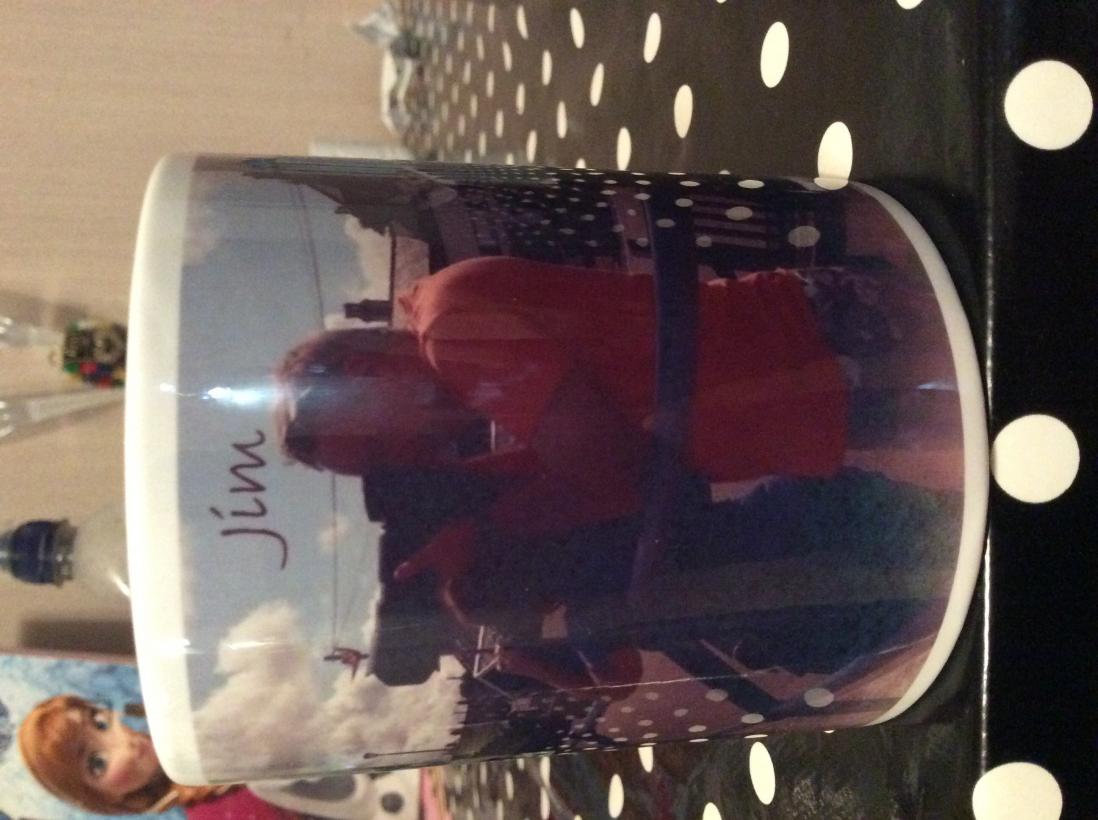

It is not very clear but this is the duff one

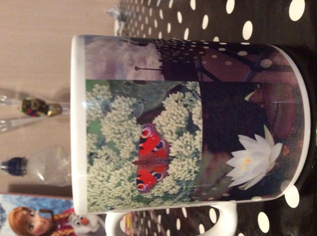

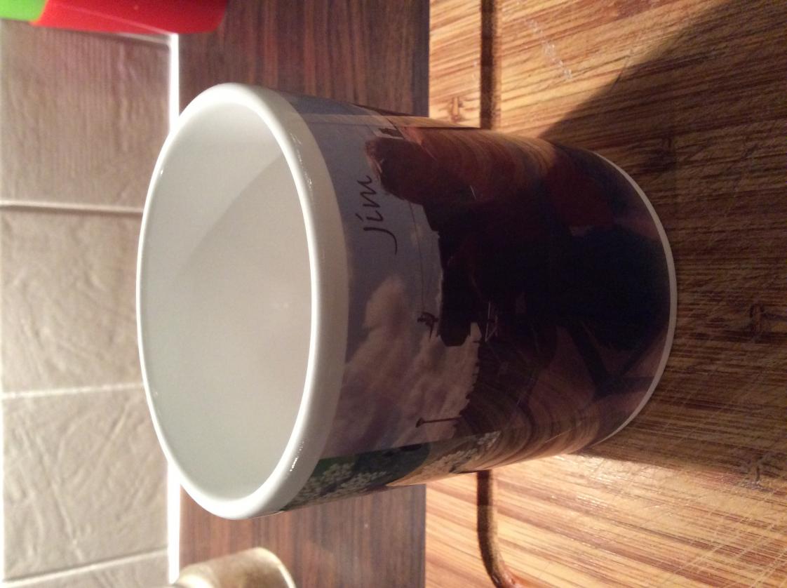

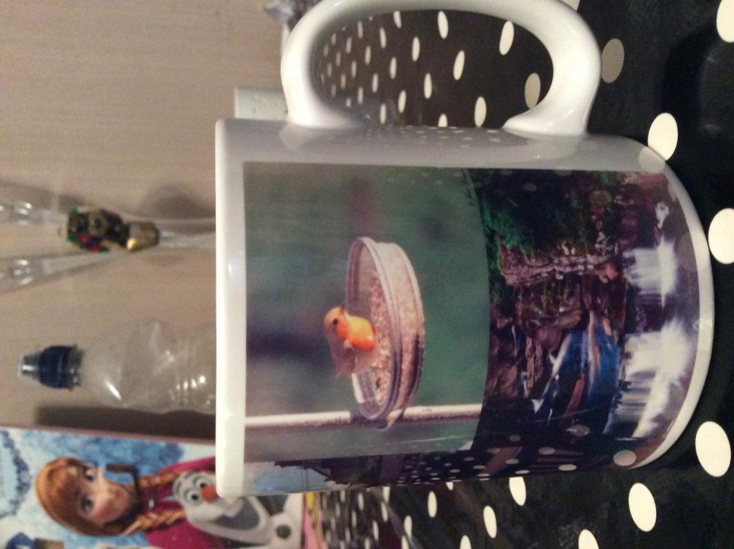

Here are some better photos

When we do photo mugs or artwork with high surface areas of flat colours then we have to change temperature and duration when pressing. Usual mug (normal graphics) we do at 170c and 140s but photo mugs we do at 180c and 180s. Olly

have to say that those mugs look just like ones that could do with getting the bottom of the mug much warmer before they go in the press. I have had the same problem and preheat has always cured it.
