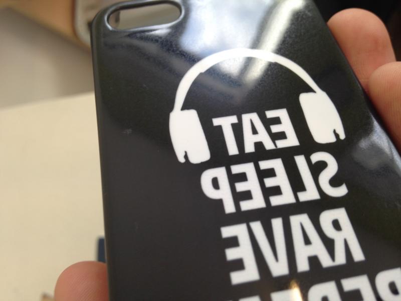

after finally getting some decent cases that actually print and not melt I've not run into my next issue (the joys of printing) I keep getting what I can only describe as blemishes a sort of sticky residue look on the print. Below are a couple of images.
I using truepix paper, sawgrass inks and a Ricoh 3110 printer.
(I know the print is backwards)
[ATTACH=CONFIG]2558[/ATTACH]
The cases look fine before print. Anyone have any any idea why this might be?

All my cases come out like that. It doesn't really bother me though. I don't think anyone would really notice unless looking at it at a certain angle/light.

Yes, that's the characteristic of the glossy case...It has that "water residue" look

I think it's possibly because in comparing them to a much superior print quality which I currently get sent to me but the cost of that is silly money compared to how much it costs me the produce a case now.

I had this to begin with but all fixed now. I think the residue is simply ink that hasn't bonded with the substrate. I wasn't drying my film/paper for long enough or cooking for long enough.

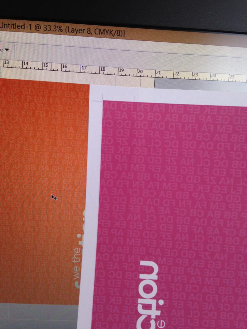

Still getting the same issue and now also noticed the colours are coming out wrong im trying to print an orange design and I just get pink!

Oaten;85576 wrote:Still getting the same issue and now also noticed the colours are coming out wrong im trying to print an orange design and I just get pink!

Oaten
Posts: 56
Joined: 02 Mar 2014, 12:38
Re: Printing quality issues
Post by Oaten »
Yeah Sublijet R Inks
3D Vaccum oven
Powerdriver 4
photoshop cs3
I have checked all my settings and everything is as it should be.
